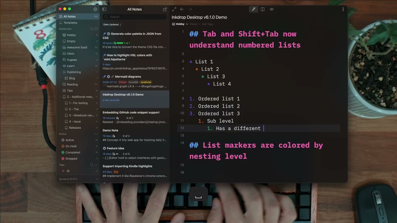

Tab and Shift+Tab now understand numbered lists
Before, Tab always indented a list item by two spaces.
That is enough to nest an item under a bullet (- ), but not under a numbered item (1. ) — there, a nested item has to start three spaces in, right under the text after the number.
So a bullet under a numbered item didn’t render as nested until you added the third space by hand.
(forum report, thanks @KiNG_N)
Now Tab indents a list item by exactly the right amount for the item above it: two spaces under - , three under 1. , four under 10. .
For example, press Tab once on the second line here:
 1. This is a line of text.
-  - This is a bullet point indented with 2 spaces.
+   - This is a bullet point indented with 3 spaces.
Shift+Tab does the reverse.
Numbered lists are renumbered automatically when an item moves in or out, and one undo reverts the whole change.

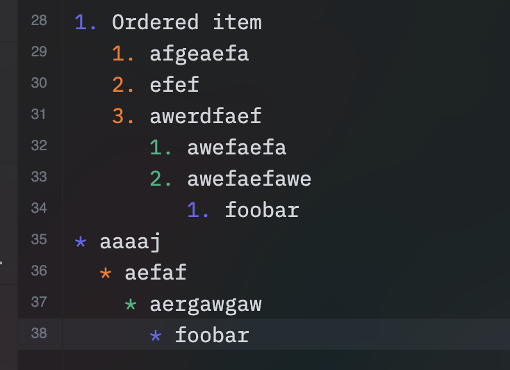

List markers are colored by nesting level
Bullets and numbers in the editor now get a distinct color at each nesting level — level one keeps its usual color, levels two and three get their own, and deeper levels cycle through the same three — so the structure of a deeply nested list is visible at a glance.
Only the marker is colored; the text of the item is left alone, which keeps it from getting distracting the way per-level text colors did in the old editor.
Themes can set the colors through the new --md-list-mark-2-color and --md-list-mark-3-color variables, next to the existing --md-list-mark-color.
The preview has matching --mde-preview-list-marker-color, --mde-preview-list-marker-2-color and --mde-preview-list-marker-3-color variables; they default to the text color, so preview markers look the same as before unless a theme opts in.
