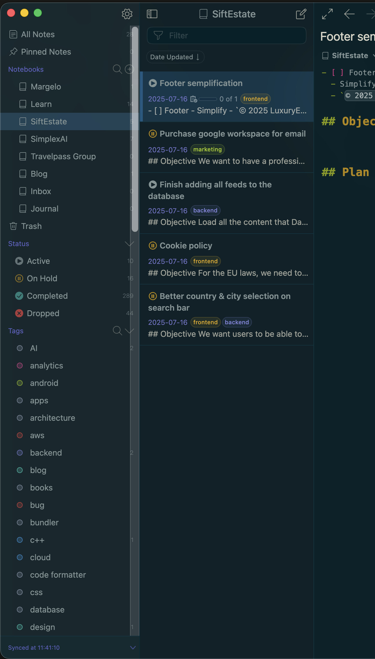

- The scrollbar on the sideview is on top of the number (see image)

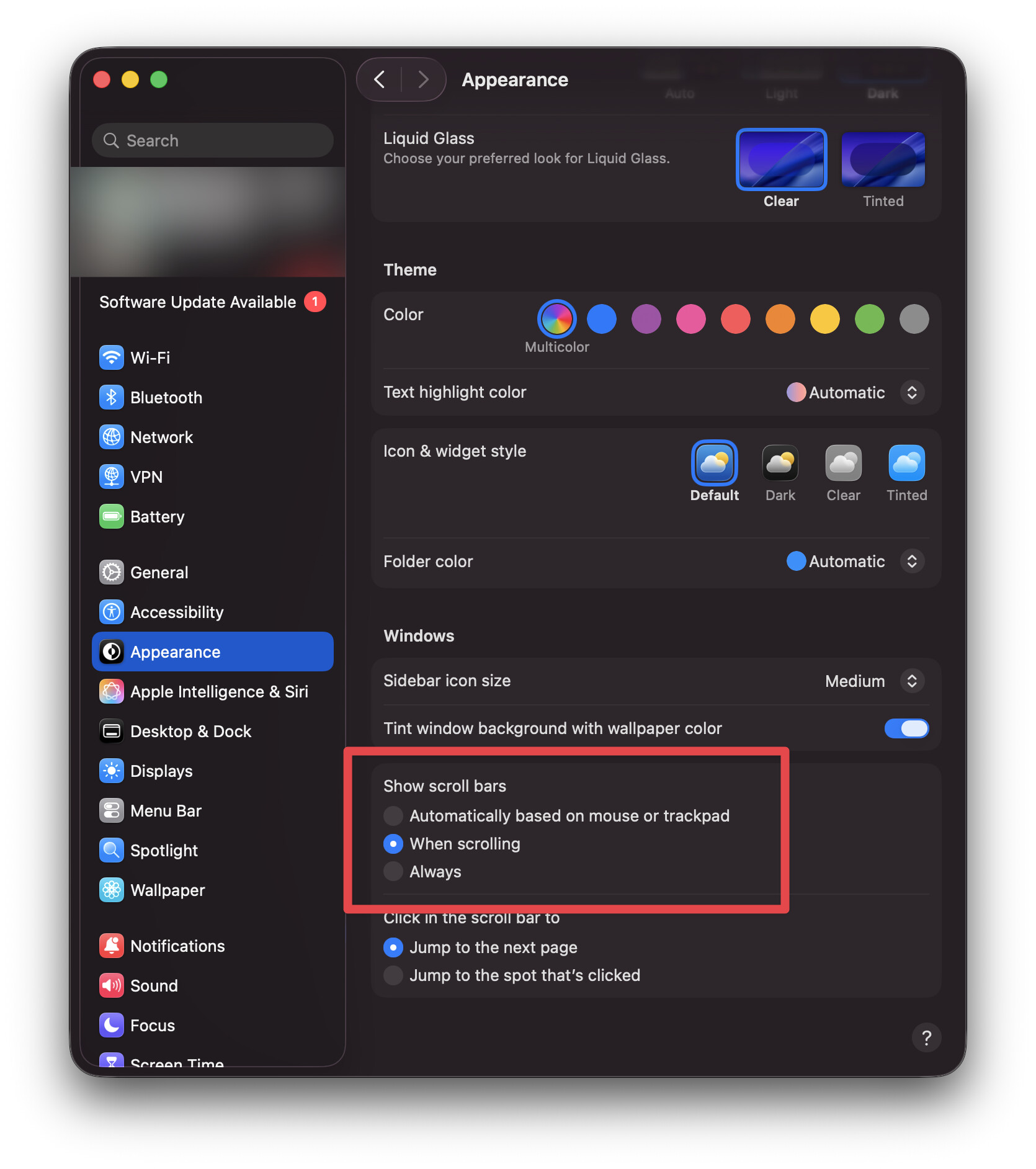

For scrollbar, please check the system settings:
If it’s already “When scrolling”, hovering on the scrollbar usually hides it.
