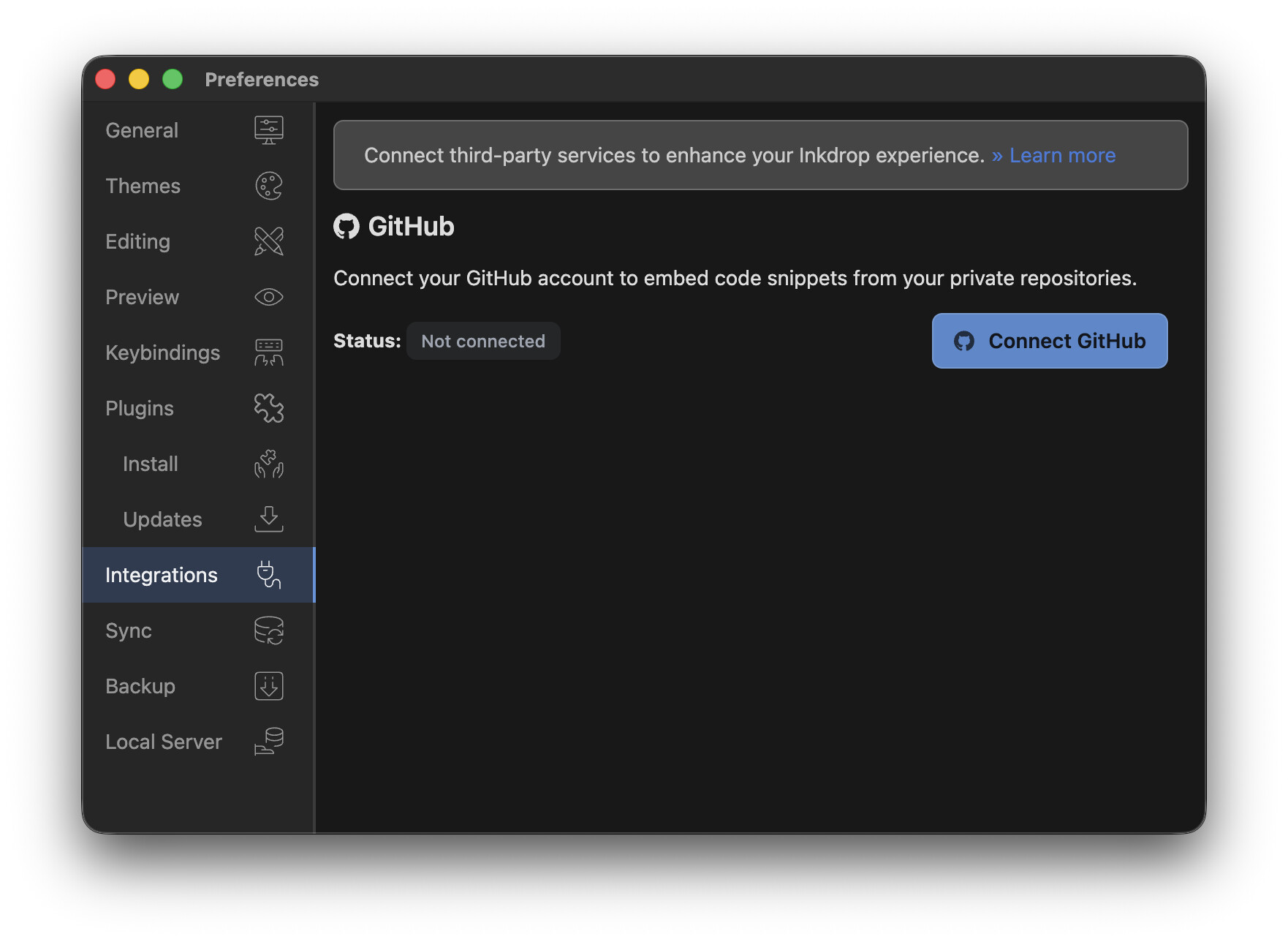

Improved GitHub Integration with OAuth
You can now connect your GitHub account to Inkdrop via OAuth.
This allows the app to read your private repos to provide the following features:
  • Embedded GitHub code snippets — When you paste a GitHub source link (e.g., https://github.com/owner/repo/blob/main/src/index.ts#L10-L20), Inkdrop fetches the code and embeds it as a syntax-highlighted code block in your note. This now works with private repositories, too.
  • Rich link titles for GitHub URLs — Pasting links to GitHub repos, issues, pull requests, commits, and source files now auto-fetches descriptive titles using the GitHub API, including for private repos.
Go to Preferences → Integrations and press Connect GitHub to connect your account.
The access keys are securely stored in the remote database with end-to-end encryption. No need to authenticate on each computer. The keys can’t be accessed in the renderer process and are only used in the main process.
