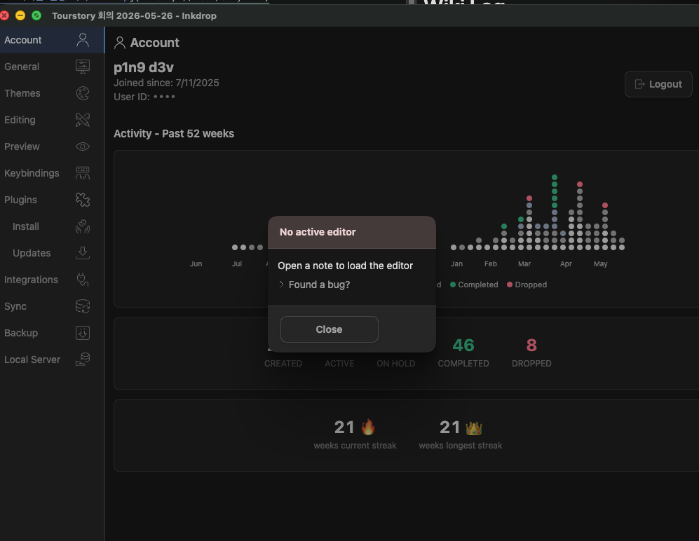

Canary v14 - No active editor Bug
Error: No active editor
    at sf.getActiveEditorOrThrowError (file:///Applications/Inkdrop.app/Contents/Resources/app.asar/browser-main.js:2:1270616)
    at Op (file:///Applications/Inkdrop.app/Contents/Resources/app.asar/browser-main.js:2:1231125)
    at file:///Applications/Inkdrop.app/Contents/Resources/app.asar/browser-main.js:2:1243223

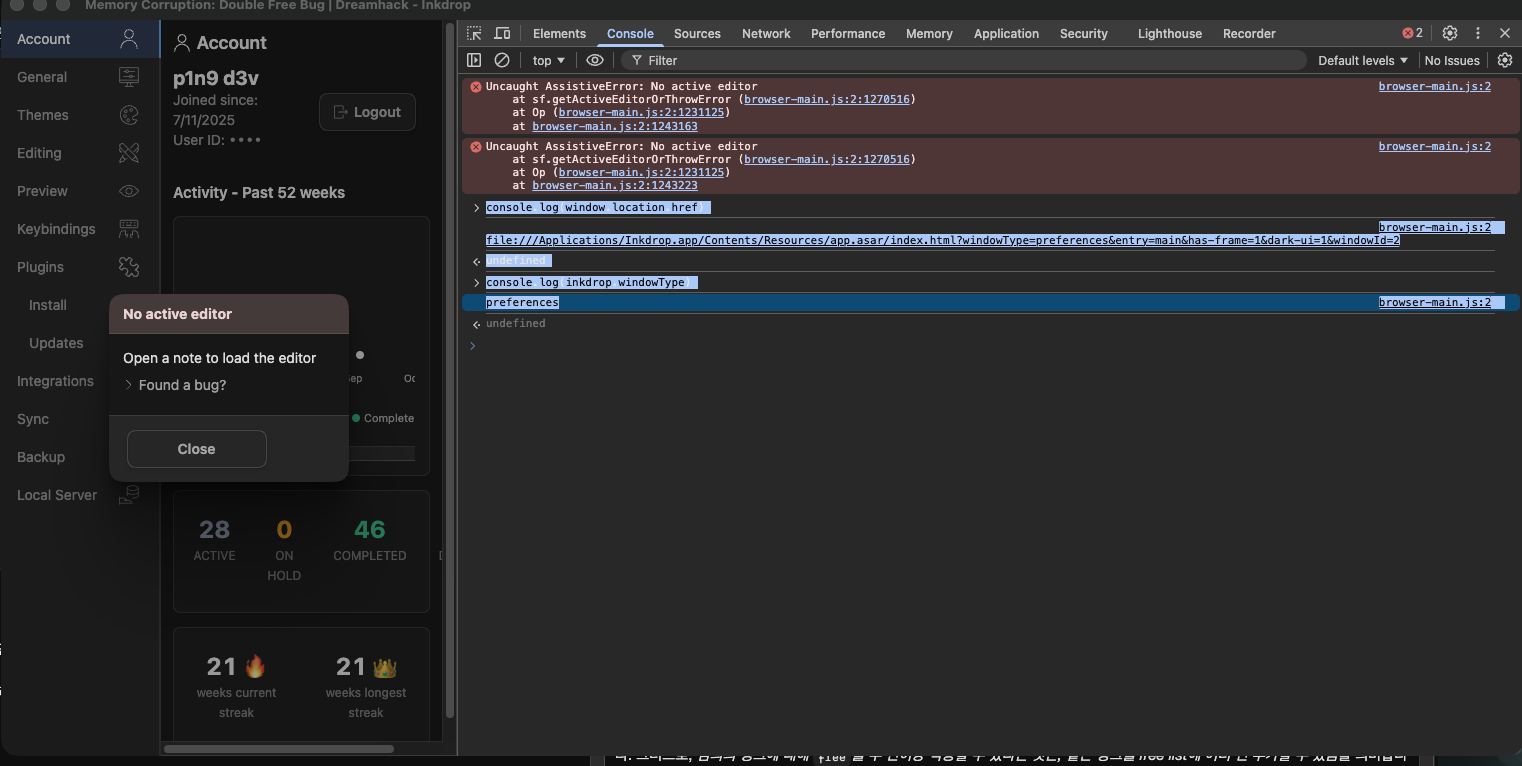

The error occurs when I open the settings window.
OS: Mac
Inkdrop: canary v14

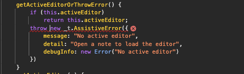

This line invokes core:open-note for some reason. Does the callstack have remaining lines?

It occurs the same error after upgrading to Canary v15
and this is the log for window.location.href and inkdrop.windowType
browser-main.js:2 Uncaught AssistiveError: No active editor
at sf.getActiveEditorOrThrowError (browser-main.js:2:1270516)
at Op (browser-main.js:2:1231125)
at browser-main.js:2:1243163
at browser-main.js:2:1243223
console.log(window.location.href)
file:///Applications/Inkdrop.app/Contents/Resources/app.asar/index.html?windowType=preferences&entry=main&has-frame=1&dark-ui=1&windowId=2
undefined
console.log(inkdrop.windowType)
browser-main.js:2 preferences
undefined

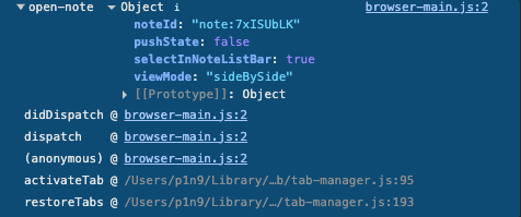

I added a debug log and built a binary:
https://d3ip0rje8grhnl.cloudfront.net/tmp/inkdrop-6.0.0-canary.15-arm64-mac_patch-1.zip
It will output a trace log in the core:open-note command handler so we can see the full stacktrace in the developer console. Can you try it?
Note: This is a binary built from the latest codebase
Thank you for your reply.
I don’t know when this error occurred.
I installed the binary, and I get the log below.

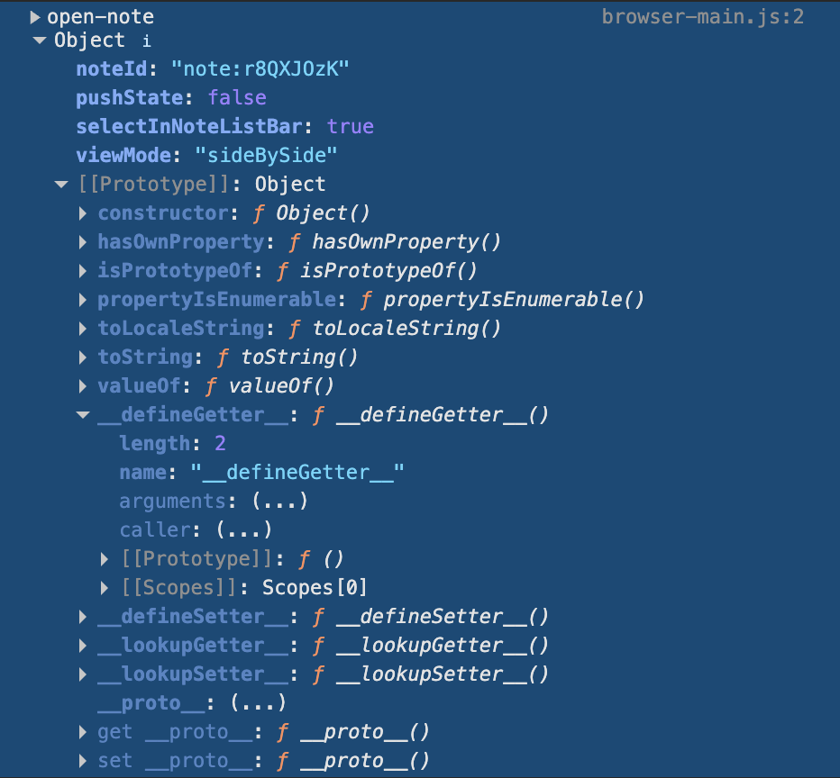

cool. Could you expand the left toggle of “open-note”, which gives us the stacktrace?
Oh, sorry, Is this the right log?
browser-main.js:2 open-note ObjectnoteId: "note:7xISUbLK"pushState: falseselectInNoteListBar: trueviewMode: "sideBySide"[[Prototype]]: Object
didDispatch @ browser-main.js:2
dispatch @ browser-main.js:2
(anonymous) @ browser-main.js:2
activateTab @ /Users/p1n9/Library/Application Support/inkdrop-canary/packages/note-tabs/lib/tab-manager.js:95
restoreTabs @ /Users/p1n9/Library/Application Support/inkdrop-canary/packages/note-tabs/lib/tab-manager.js:193
    at xf.getActiveEditorOrThrowError (browser-main.js:2:1218619)
    at Mp (browser-main.js:2:1178211)
    at browser-main.js:2:1190595
    at browser-main.js:2:1190655
Gotcha.
The plugin note-tabs was calling the core:open-note command.
The root cause is that plugins are unexpectedly activated in the preferences window.
I’ll fix it in the next version. Thanks!
