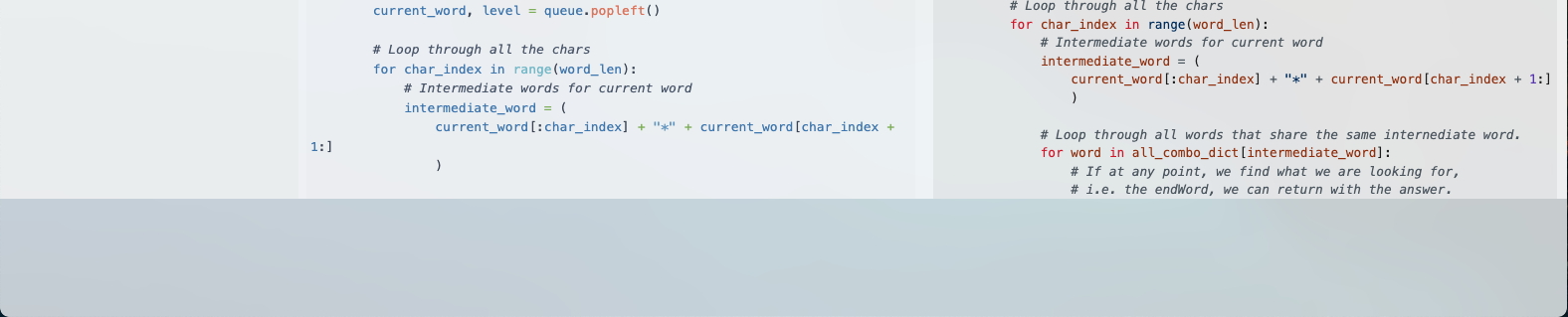

  4. Try to click the link. And you’ll see there’s a big area of gray at the bottom of UI.
Can someone please help me get rid of this? Thanks!

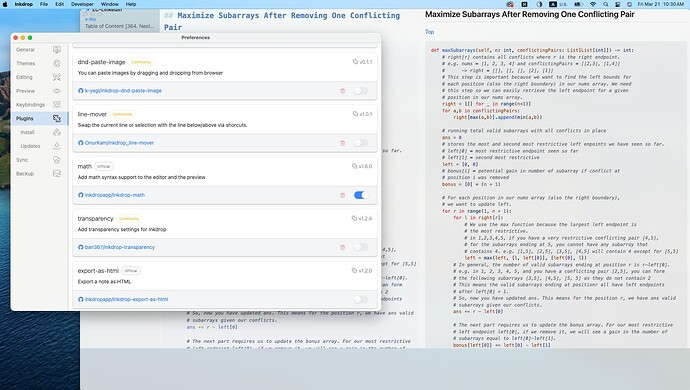

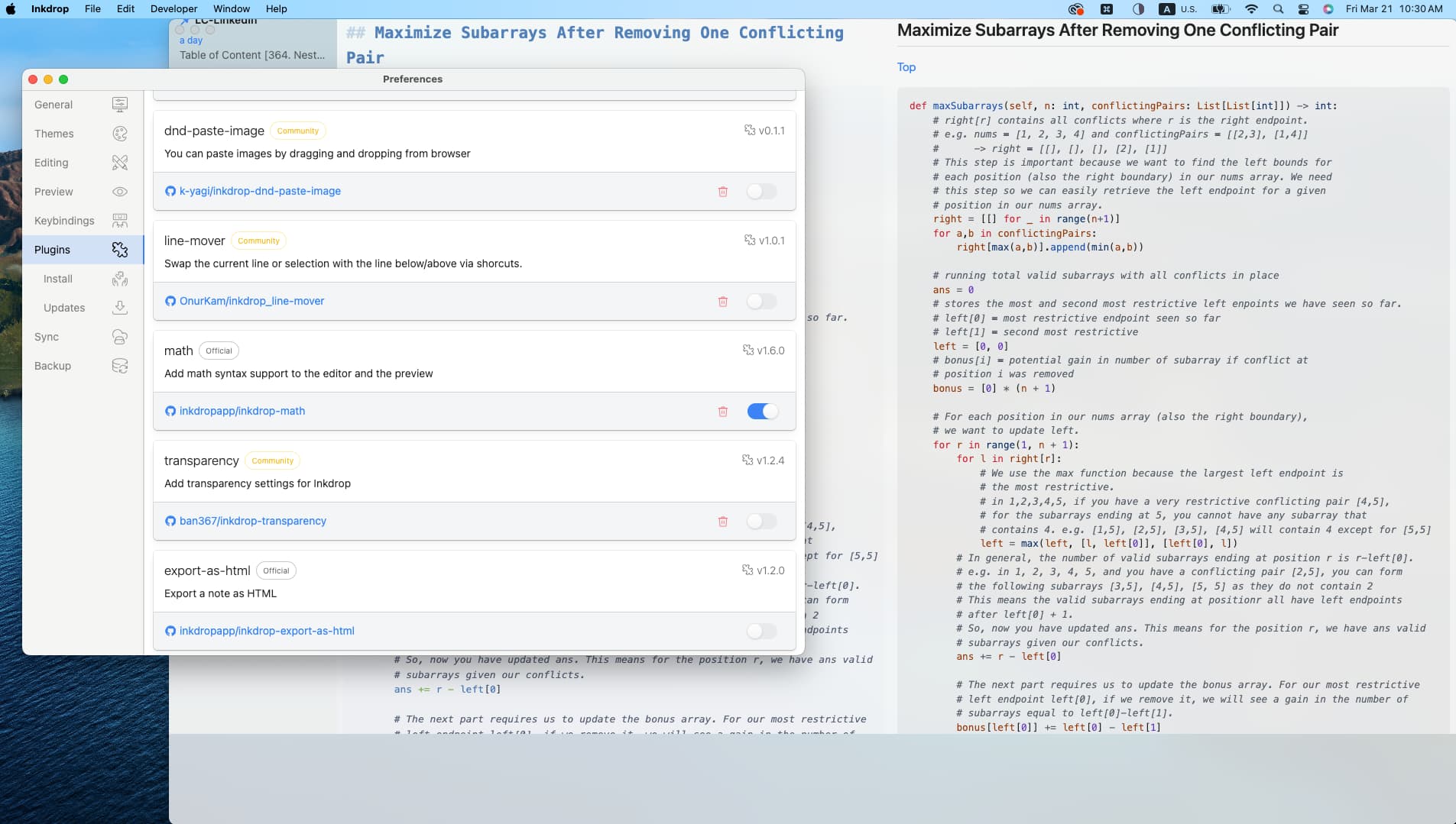

Okay, after going through some of the issue posts, I was inspired by one of them that it may be caused by one or more of the plugins I installed. So I deleted the plugins one by one and tried the links and I found it was the official math plugin (v1.6.0) caused it. After I removed it, the UI and the links work fine.
Since math is the official plugin, can you please also fix it? I really like it and it’ll be great if it doesn’t cause this weird UI issue. Thank you.

Thanks for your reply!
Yes, so it happened again after I disabled all the plugins except for math.
The Theme I’ve been using is the Default Light, for both UI and syntax.
Please don’t forget to relaunch (or reload) the app since some plugins don’t clean up properly.
Yes, I did that every time I installed or uninstalled a plugin.
