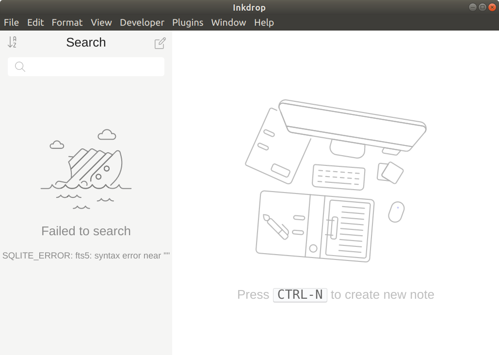

Second problem: blank search term with a space results in error:
  • SQLITE_ERROR: fts5: syntax error near “”
  • see screenshot:
    • “screenshot with blank search term”
Ah that’s a bug! Will fix it in the next release.
