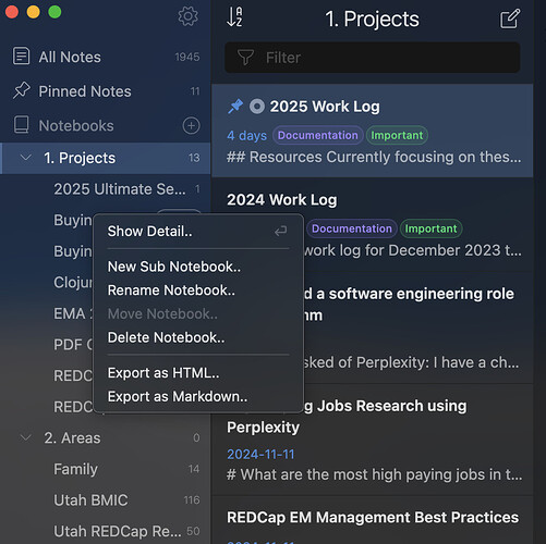

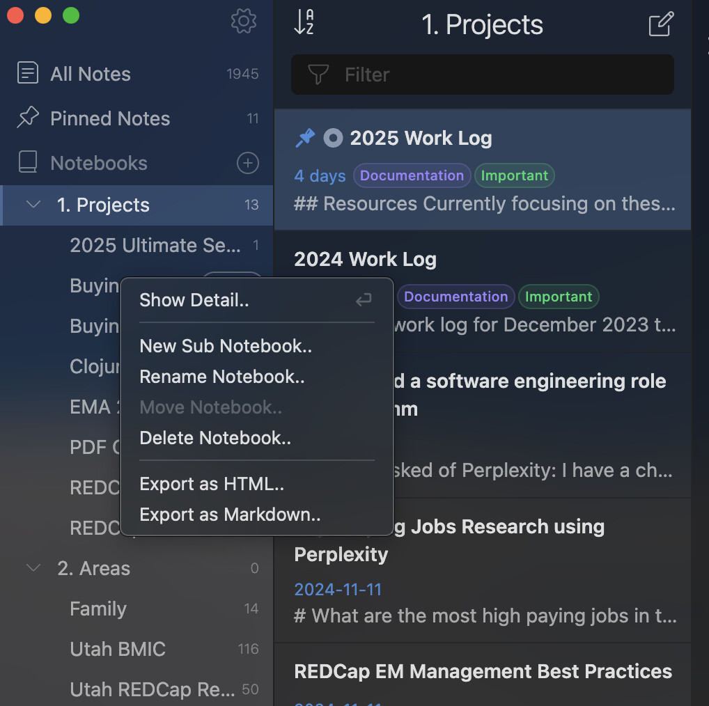

Unable to move notebooks from the sidebar menu
I noticed today (May 9th, 2025) that I can no longer move notebooks while in the sidebar menu. The “Move notebook” option is grayed out when right clicking on any notebook:
Is there a setting I am missing that would enable this? I haven’t recently had to move notebooks around so I’m not quite sure when it was last available.
I tried restarting both the app and my machine and the issue persists :confused:
  • Platform version: Sequoia 15.4.1
  • App Version: 5.11.3
  1. Open app
  2. Right click on any notebook in the sidebar
