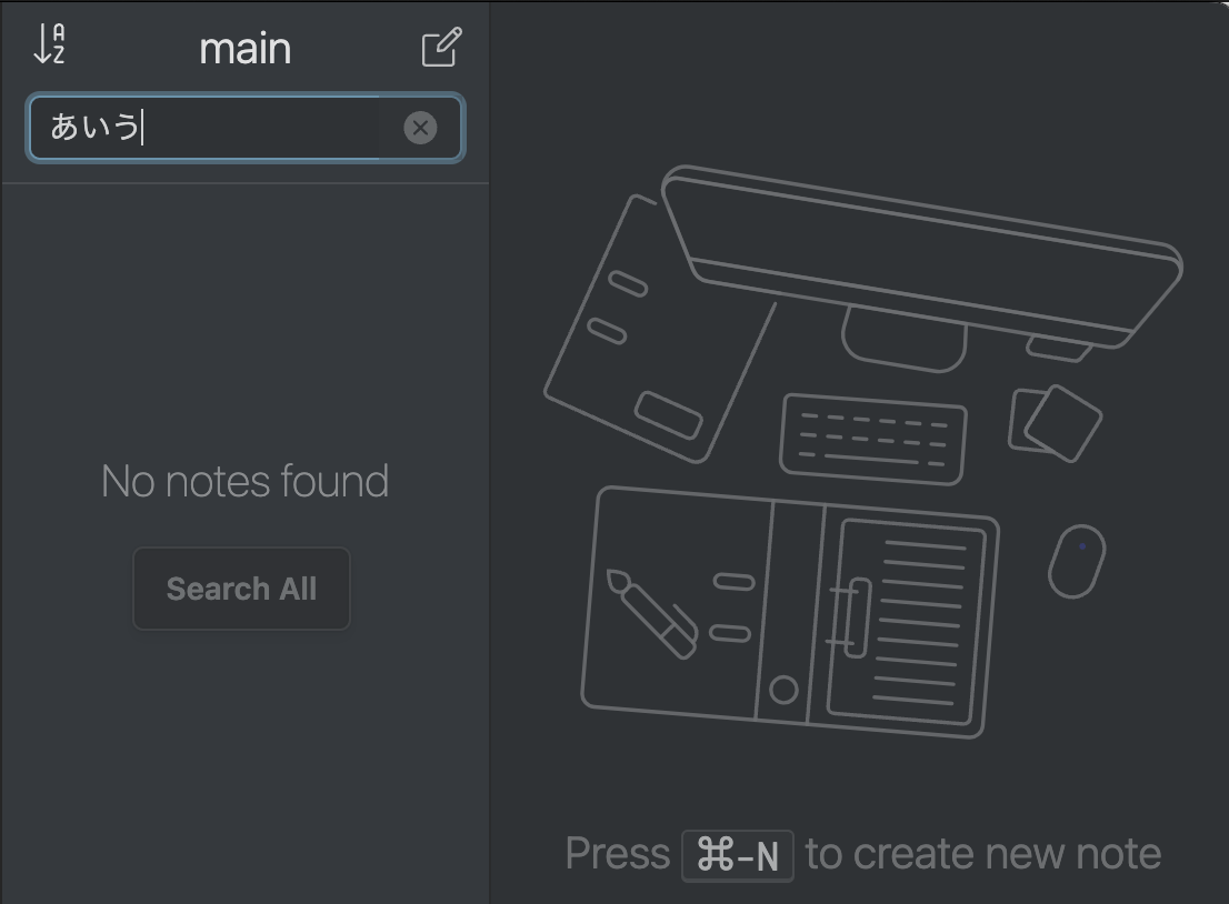

The editor is unloaded when no matching note is found in search
Is it intended behavior that the editor gets unloaded when there are no matching notes during a search?
When the editor is unloaded, any event listeners or settings applied to the editor via inkdrop.getActiveEditor() or inkdrop.onEditorLoad((editor) => ...) are cleared.

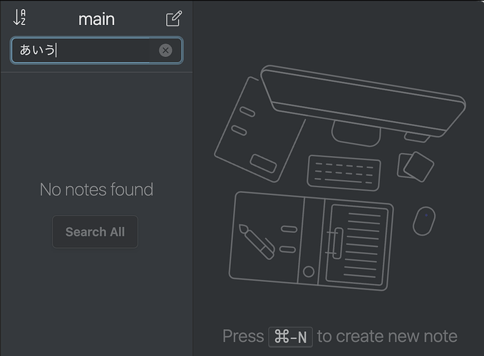

  • Search using a word that yields no results.

Hi @shimizu_tatsuya -san,
Yes, that’s intended. The editor should be unloaded when nothing is selected on the note list.
When the editor is loaded again, the onEditorLoad event is fired.
So, you should always listen to this event in activate in your plugin, like the vim plugin.
