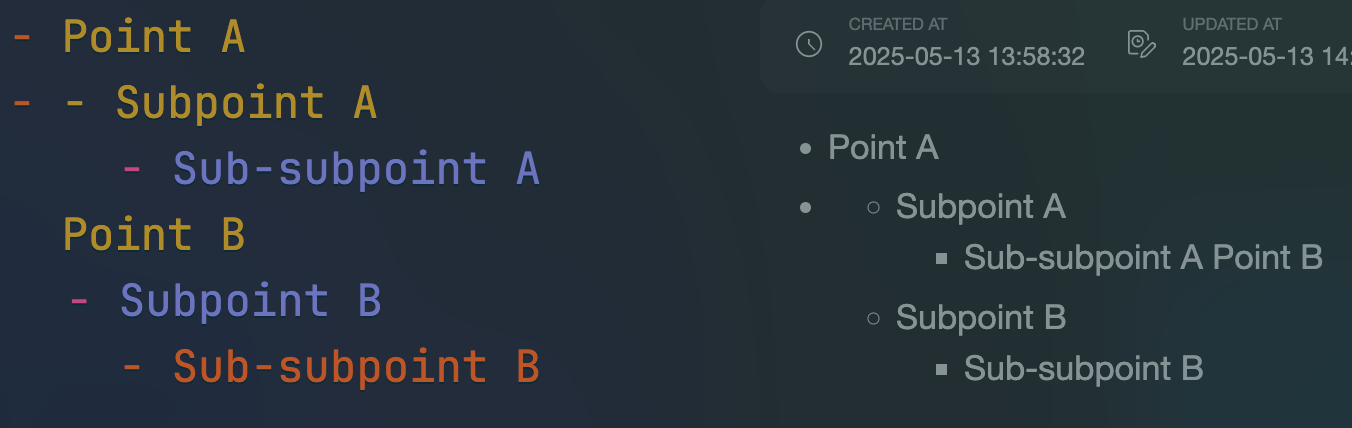

Logseq, Sublime, Inkdrop (in order):
@J_N
Inkdrop does not convert tabs into spaces when pasting.
Do you mean changing the tab size does not work?
Why does the second line start with - - and why does the line “A” not have a dash? How do you paste it?
I don’t know :sweat_smile:
This is the behaviour I’m seeing, and it seems to vary with apps I’m pasting from. There seems to be a difference between ⌘C + ⌘V pasting and Pasting as plain text ⌥⇧⌘V.
  1. TextEdit/Sublime
- Point A
	- Subpoint A
		- Sub-subpoint A
- Point B
	- Subpoint B
		- Sub-subpoint B

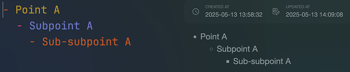

Nothing fancy, just tab-indented text, ends up in Inkdrop like this:
There’s some kind of invisible indentation happening because a) the syntax colour is different for every line, and b) the dashes aren’t perfectly aligned. Preview seems to render correctly.

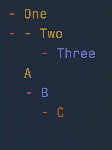

  1. Logseq
    If I do Paste as plain text ⌥⇧⌘V, I end up with the same result, but if I simply do ⌘C + ⌘V, then I end up with this:

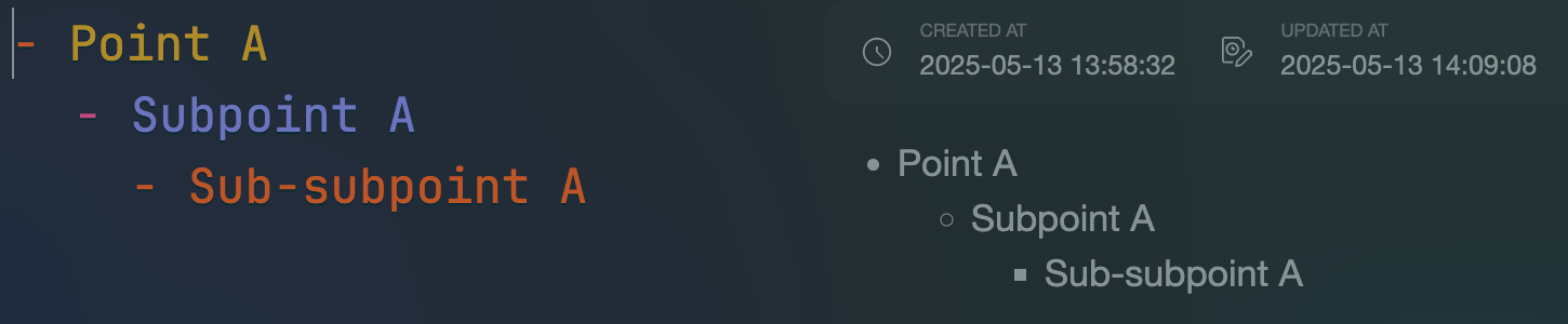

However, this is where things get weird, if I ⌘C + ⌘V just Point A and its children, I get this:
All the dashes you see here are indented by 2 spaces, even though my settings in Inkdrop are Indent unit:4 and Tab size: 4.
Bottom line is, no matter what I do, I can’t seem to get tab-indented text into Inkdrop correctly. I’m guessing for now, manually changing tabs to spaces is the only option?

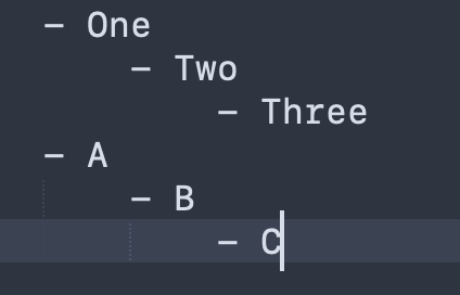

I’ve given this a spin, here’s what I find:
  1. Plain text
    • Tabs convert correctly to whatever config I have set for indentation (I’ve tried changing from 4 to 2 and back again, and it looks like it works), so this is good.

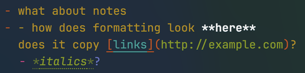

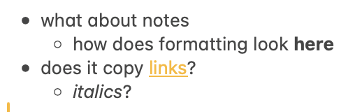

  3. Rich text

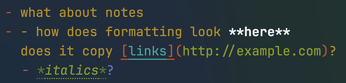

    • Still getting double dashes when pasting from rich text, i.e. from Apple Notes (see below).
    • If I paste rich text with ⌥⇧⌘V, I’ll get varied results depending on source application, but I guess that’s a different issue.
Apple Notes, rich text:
The main takeaway is that tab-indented plain text now seems to transfer correctly, which is a win :slight_smile:
@J_N Thanks for checking it out!
Yes, you are correct. Seems like Apple Notes has the same issue with Logseq.
You copy HTML like this:
<ul class="ul1">
   <li class="li1"><span class="s1"></span>what about notes</li>
   <ul class="ul1">
      <li class="li1"><span class="s1"></span>how does formatting look <b>here</b></li>
   </ul>
   <li class="li1"><span class="s1"></span>does it copy <a href="https://www.inkdrop.app/">links</a>?</li>
   <ul class="ul1">
      <li class="li1"><span class="s2"></span><i>italics</i>?</li>
   </ul>
</ul>
The child ul is directly under the parent ul, which is actually incorrect and not supported by the converter library.
Well, I guess it’s good to roll this patch out. Thanks again!
