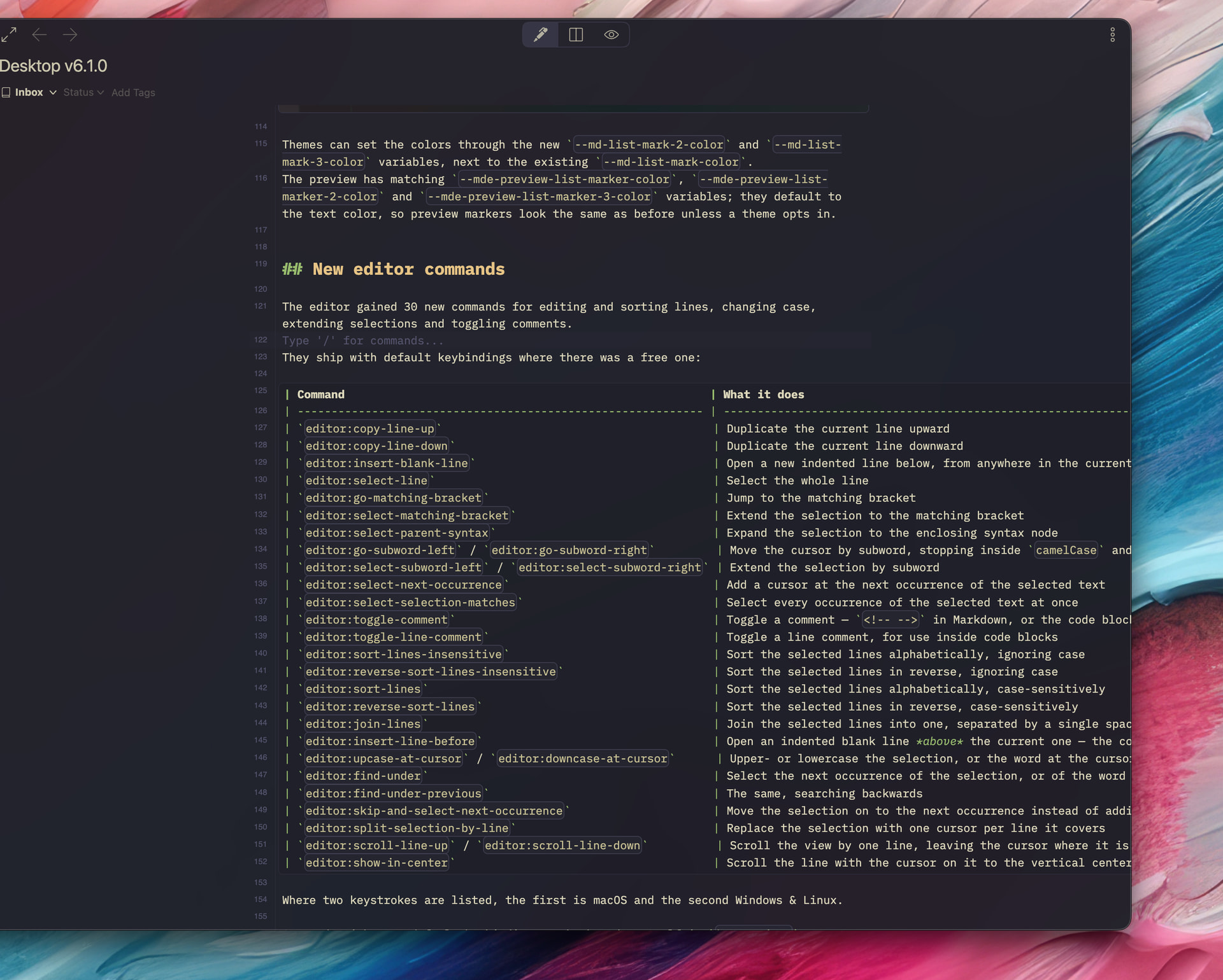

Result:
It scrolls the entire viewport instead of the table blocks, but I think it’s fine as a plain-text editor.
However, I think there would be a few quirks to fix, so we should carefully test it.
For example, the text selection layer is broken when selecting multiple lines.
I also found a few bugs in the editor decorations during the exploration.
