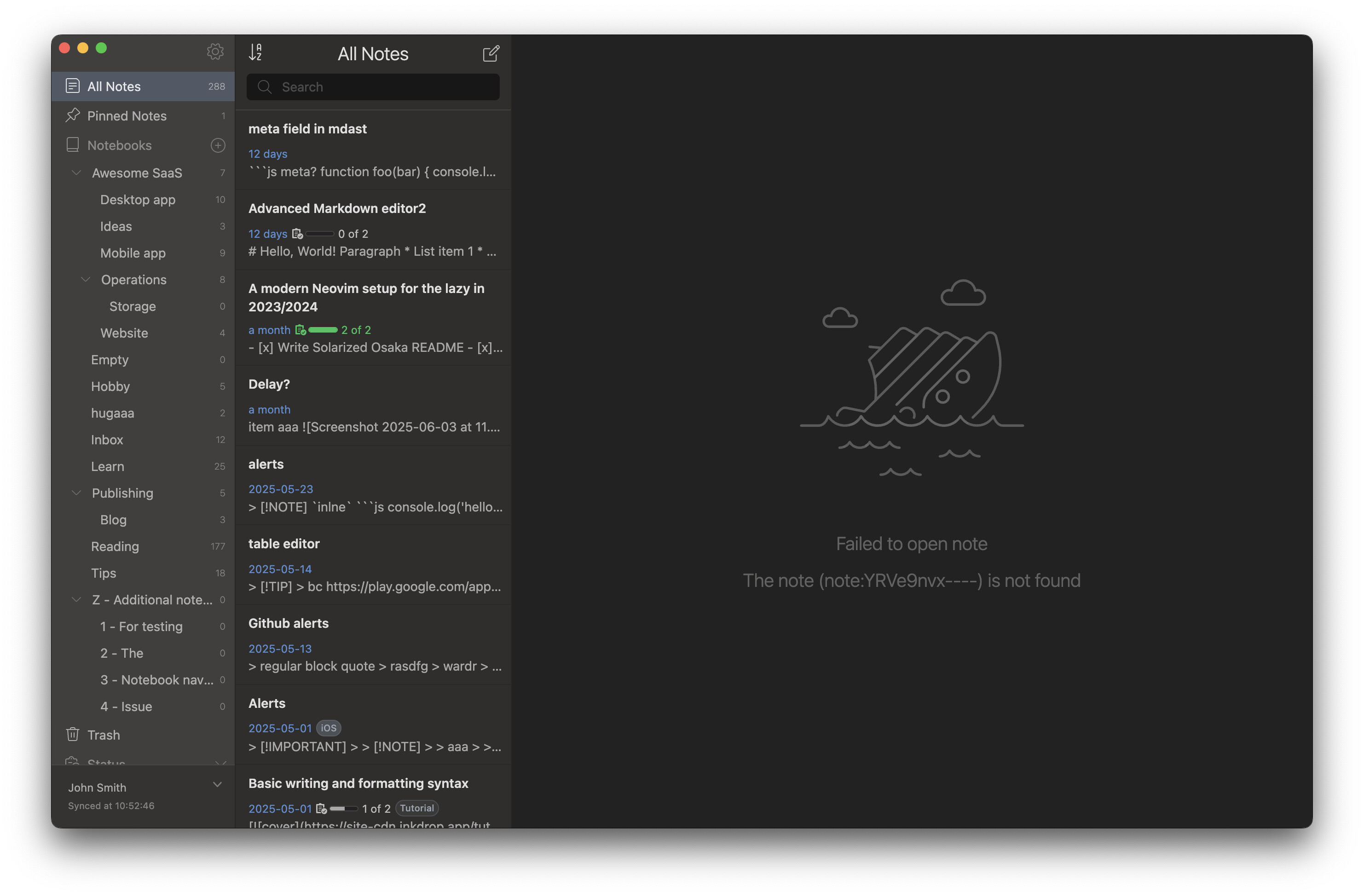

Hi @anon47640485 ,
I tried to reproduce it by setting an incorrect note ID in core.lastNavigationState.editingNoteId, then I get this error screen, which is expected:
instead of what you reported like “The 404 error blocks the entire application from functioning”.
In my environment, it correctly tells you that the note does not exist, and you can select other notes :thinking:
So, it’s strange that the app fails to start with 404 error on your end.
Is it possible to share any stacktrace in the Developer Console?
