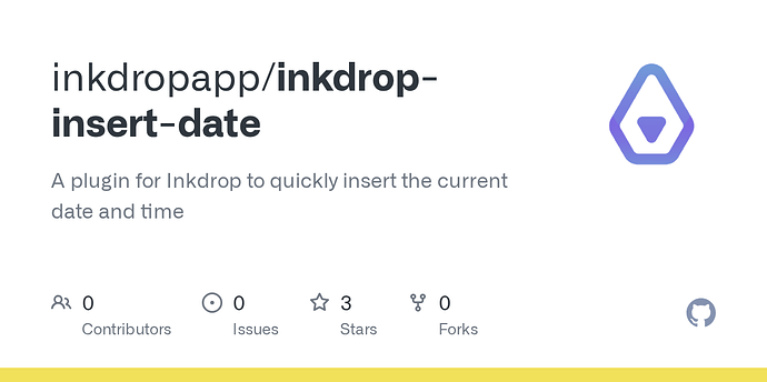

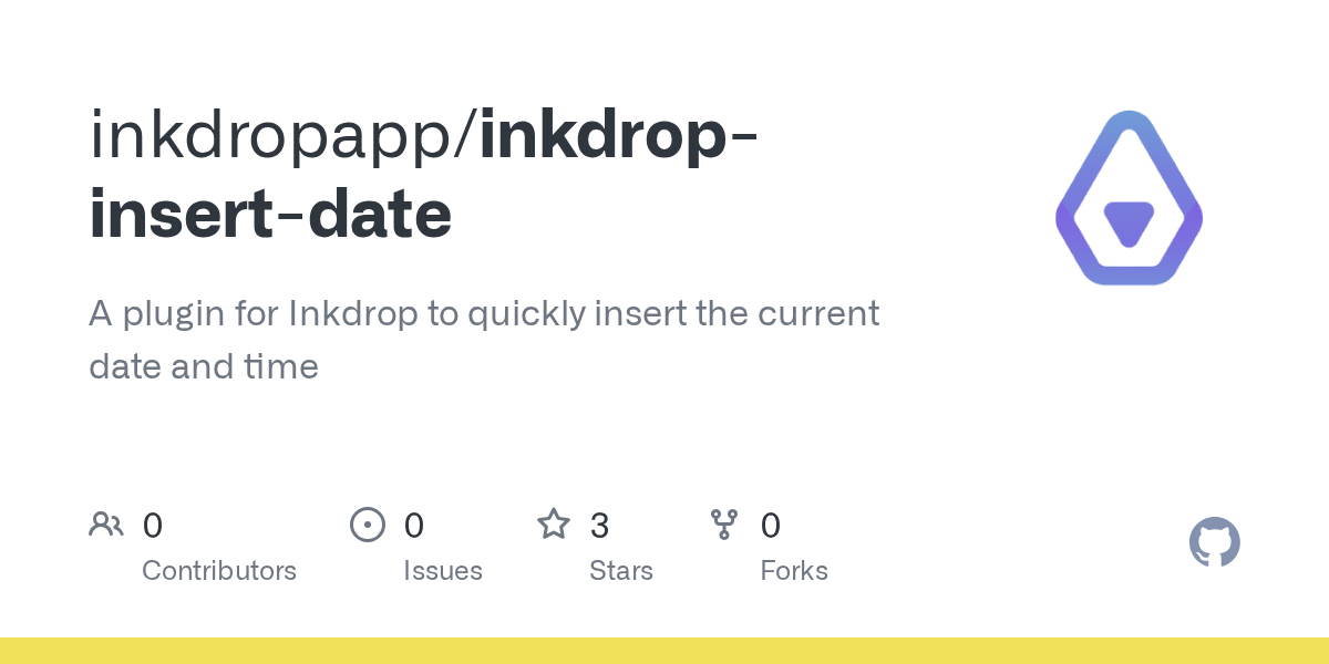

I would like to make a plugin where you can press a keyboard shortcut and it will insert a pair of single backticks if the cursor is not inside a word. If the cursor is inside a word, the keyboard shortcut insert a pair of backticks around the word where the cursor is. Also multiple words could maybe also be selected with the mouse, and the keyboard shortcut would then apply to the selection. Or alternatively, a right mouse click on the selection will bring up a context menu with a “Backticks” menu item that can be chosen to insert a pair of backticks around the selected text.

Keyboard shortcut for inserting backticks
Sounds great. This plugin is the simplest one to copy:
Hope that helps!
