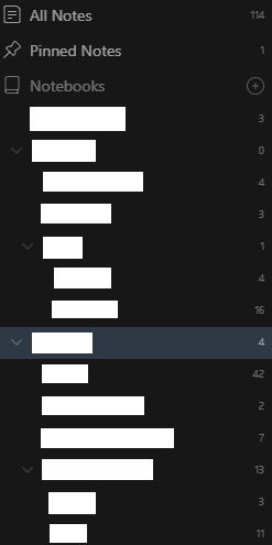

I have given it a test with the test account and I was unable to reproduce the bug. Based on my experience with issue 2 below I think one possible reason why I wasn’t able to reproduce on the test account is that it has fewer notes and nested notebooks. I didn’t have time to try recreate my setup but the notebook tree looks like this.

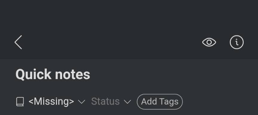

  3. After the complete reinstall I noticed that all my notes had the notebook listed as <missing>, this was during the first time opening the app after installing it again. I then closed and opened it again and now the listed notebook was shown correctly.
I have a picture of the last issue but the others I couldn’t capture

I have managed to reproduce the issue on the test account, which also means that I have a video of it now. I had to create a few extra notebooks to reproduce.
It turns out I had been thinking about it all wrong and it’s actually a lot easier to explain and reproduce than expected.
Essentially I cannot navigate to any notebook that would be out of view when scrolled to the top of notebook list, and if I do click on one of those then navigation to other notebooks break, I can however still navigate to all notes and pinned notes.
Having clicked on one of the notebooks initially out of view and then trying to log out is probably what broke that button too.

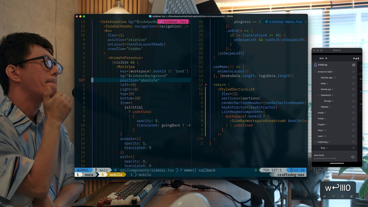

I managed to reproduce it!!
I also found how to reliably reproduce it.
It happens if the scroll position of the sidebar is NOT topmost.
So, it works fine if the sidebar scroll position is top.
But it doesn’t work if you scroll down to a particular notebook item to click.
I suspect that the tap position is incorrectly handled in React Native.
It only happens on a real device.
It doesn’t happen on iOS.
So, I guess this is a bug of React Native :joy:
I’ll try to find a workaround.
